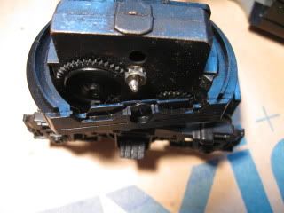

Tyco has the worst record for recovery. If it wants to turn but doesn't look at the gear drive in the truck. A mount could of broken off. Remove that gear. If the gear powers only one axle it will run with the other,if not your done.It will not go if you are missing traction tires. You can remove all the gears and use it as a dummy.
You are lucky you have a three Bob answer.
Does it look look this?
