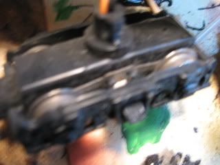

My little D&RG
Well, it was running just great! Lil Trooper! Even without any traction tires.
But all of a sudden the other day it decided to just sit there spinning its wheels.
It's a strange little thing, in that the power is all in the tender. It pushes the loco! Or, in reverse, it pulls the loco. And since the connection between loco and the tender is broken, that means it only pulls by the two fine wires connecting them.
It will travel if I put my finger on the top of the tender, so I added weight, and it ran a little better, but not good. Added 6 pennies.
Soooo...... do I go for putting on traction tires? Bull Frog Snot? Or trash it and invest in some more expensive locos?
penlu is offline   Reply With Quote
Old 08-17-2011, 10:49 AM   #7
Posts: 7,791
Images: 259
Try again with the second picture. Turn off the flash . I prefer the dental elastics.
