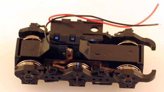

Since I don't own a Bachmann cable car I am not sure how much the engine/chassis comes up into the cab of the car which might interfere with the seats. Any suggestions?

The roof looks close enough to my eye....I think a dremel with a cut off wheel would work. the seats are very simple in design as well as the vertical poles and front and rear should be easy to replicate. The rooftop sign also looks easy to make. My LHS carries plastic and brass poles.
The Bachmann cars are motorized in the open seat section, it is self contained and clips out, much like a battery pack. The one you see pulled thru the neighborhood on his show was kitbashed from an old TYCO HO trolley. It was not motorized like the larger one and was pulled across the set via a fishing line attached to a stick under the set. The builder did this because there was no way to motorize it without interfering with the seats.

If the motorized unit is narrow enough I might be able to make the seats go from the outer edge of the car up to to motor unit on each side. That might work. The seats would not go all the way across the car but that would still give me the open air look I am after. At $25 for a Bachmann trolley car, it might be worth a try. It would be nice to wire up a headlight and tail light as well as lights in the roof below the "Neighborhood Trolley" sign. Thanks for your suggestions.

I do not know if this would work but here are a few ideas I have. Is it possible to hide an N scale drive line in there just add larger wheels? What about steeling a truck from a Bachmann 40 tonner? I have one and it has a separate motor for each truck.

I am sure an N scale drive line would fit in there but the wheels would be too narrow for the HO scale tracks plus the wheels would be really tiny. I'm not sure how to make that idea work.

I don't see why that drive won't work, you would just loose the see-thru effect, but only from the seat bottom down. It would probably take two cable car bodies to make one long enough---however---that second body can be one of these...
The castings are the same as the Bachmann ones (pirated?).
useing an N scale drive system should work. You would just need to switch out the axles and wheels with the proper sized ones. It also won't be able to take major inclines with an N scale drive ssytem most likely.

That should work nicely. I will only be able to have a single seat on either side of the engine bay but the other side of the car should be able to accommodate the full row of bench seats. Does the cable car have a headlight and tail light? A few days of modifications and I should be off the the magic kingdom LOL BTW thanks for the pics.

Well I got my LED lights for my trolley mounted 1 in the cupola, 2 in the passenger compartment and one in the front of the trolley. I got the wires pretty well hidden in the cab then tried to solder the wires to the engine pickups. Well after multiple failed attempts I managed to overheat the engine and now it won't run . Today I looked online and Bachmann sells a replacement for $15 so I will order one.
