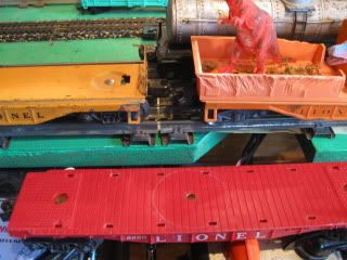

Time for another!
I bought this one hoping to switch out the caboose parts but the holes are different. The color is more yellow than orange. So I used scotchbrite and rubbing compound.
The left picture is half done on left and dirty to the right side. Last picture completed.
Then a floor shine to finish.
Any ideas on the curious hole by the truck rivet on one side??? Both 6111's have it.
A perfect Match.

My 6151 with the black-and-white Range Patrol truck uses that very same flatcar. I looked, and it has the same round hole near a truck rivet ... one side only. No idea what it's for. I suspect that the 4 rectangular holes (closer to the car midbody) were for cargo tiedowns on my Range Patrol, and for a pair of two-posted pipe stanchions on the 6111 cars. I see no apparent use of the round hole in the photos in my books on any of the 6111, 6121, or 6151.

An interesting note regarding this style flatcar is its use after production of the flatcars cars ended in 1957. A slightly modified version of the flatcar -- specifically the elimination of one end-railing -- eventually became the frame for all work cabooses manufactured by Lionel after 1957.
Are you sure that is a 6111?
I read something about the hole somewhere in my research travels, but can't it it up again.

I would imagine it is for an electrical pick-up for a special version of the car with a lighted or motored load or one that was intended to be but never was.
I think you hit the nail on the head!
If they used it for cabooses that would be for the light bulb wire to come up through the frame.

It makes sense for the wire.
The work caboose has different holes. I will get a picture. Done.
