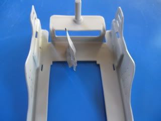

Old 11-26-2010, 10:09 PM   #30
Posts: 10,244
Images: 279
Primed
I am planning on a color scheme of a blue boiler and black frame and steamchest. I also started rewiring the motor too.
