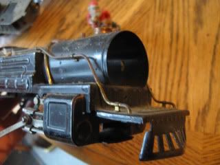

In the Junk Box I started working on a second 259e or at least parts of it.
This thread is not to be confused with the 259e Revival.
Basically I bought a shell and beat up motor. Or should I say a really beat up shell and motor. So popular was this auction that I was the only one bidder.
The old and the new or is it the other way around???
https://www.youtube.com/channel/UCkM...BLo3pJN1FGE1Gg

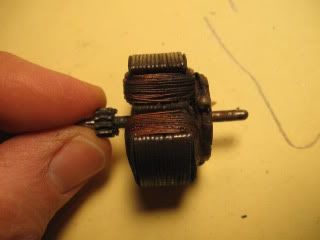

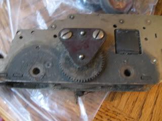

The motor was rusty so cleaning was in order. I tested the armature and it works.

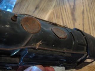

Shields / Shell

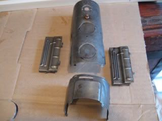

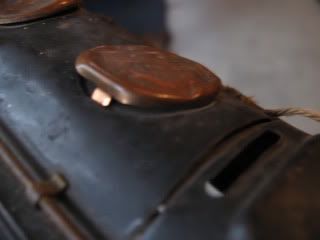

The shell as TJ coined as the Doomed Domes.
Except for the boiler section the frame and shell are in great shape.

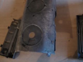

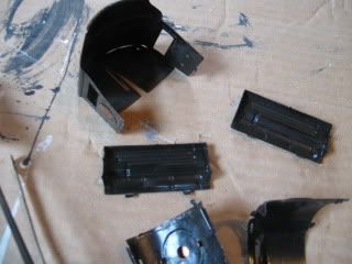

Hammer Action

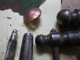

I worked on the copper domes a little at a time using a variety of hammers and washers to get the curve back. I also dismantled the shell.
I started on the boiler section too.

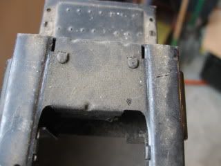

Old with Dust

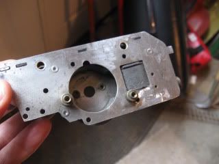

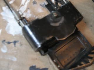

The frame and steamchest.
I reviewed TJ's Junk Yard Dog and found this one is in better shape aside from the center crush.

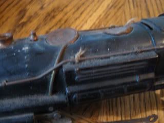

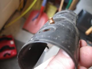

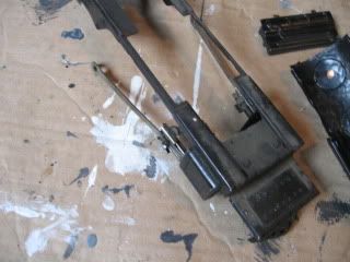

See More? Strip Time
Just in. So far the paint is sliding off. The first 259e I had to do three strips before I saw any metal. It may just be the oven cleaner. A cheep one dollar brand.
The power fizzled out at the bottom of the can for the cab and steam chest.

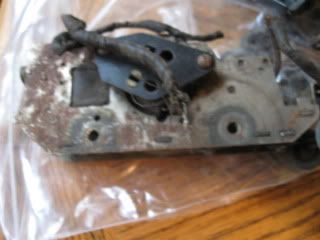

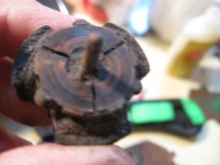

More Motor
The back side was all grease ir shined right up. The front side got the rust.
Always get the motors with axle bearings!
Mostly a dremel sanding drum was used on the frame. Scotchbrite for the copper.

2nd round
I think I will solder the cab sections together. It will help with the cab angle and prevent the Dreaded Slant.
It REALLY helps when the paint just slides off. I understand now how much TJ's elves work on the shine.
