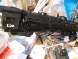

My latest is a tune up of an AF set from 1962. A childhood present of a co worker that was accidentally back over by a car. Two cars suffered and the others have the used look. A "break" from my circuits.

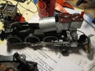

Starting with the engine, it is in great shape. The e unit is in the cab with a smoke generstor and a large air piston. The draw bar screw broke but came out and being 4-40 I have a generic replacement. The shell had a small bath too.

Tender
The tender needed a minor truck repair. Plus I painted the frame a flat black.Here I soldered the connection. There was no evidence of a connector board. I also wired in the rear axle. An indentation broke and part of the axle could move so I epoxied a wire to lkeep it in place and out of trouble.
So, while the rear truck dried,I tested and the engine graduates. WIth a little cleaning and a nudge here and there, she's running smoothly. I like the chuff sound.
