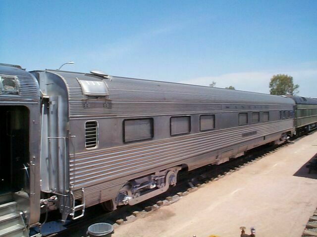

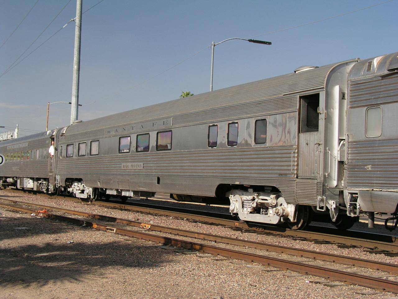

I finally found out what my Con-Cor model coach was based on, with some discrepancies in the web page writeups. Here are the links to images and web pages with the info, which are about Con-Cor #223-702 Santa Fe (whereas mine is the undecorated #223-701). The car I finally found on the net is a privately owned car renamed "Regal Phoenix", that was originally a Santa Fe coach #3166.

Santa Fe Coach [renamed] "Regal Phoenix"
Built by the Budd Company as one of sixteen cars [16?] in lot number 9613 - 001. Ordered in May 1941 and delivered in March 1946 as 52 seat coach number 3166. This car saw service on many Santa Fe streamline trains, one of which was the Hassayampa Flyer which ran from Phoenix to Williams Junction. The car went to Amtrak in 1971 and was renumbered 5236. The car was scheduled for shop work and conversion to 60 seats in 1976 but the work was never done. [Maybe this one coach escaped the conversion to "60 seat chair car" mentioned above].
Retired in1977 and sold to the U.S. Air Force the car was moved to Vandenberg Air Force Base in California. The interior was mostly removed to facilitate rebuilding as a hospitality car. The work was never completed. The car was purchased by John Clark in 1990. Mr. Clark sold the car in 1993 to Rail Preservation Inc. of Scottsdale, Arizona. The car was passed on to the museum in 1996. The Arizona Railway Museum re-named the car "Regal Phoenix" and is continuing the re-build of the car as a full lounge.

See photo:
http://www.azrymuseum.org/roster/Regal_Phoenix/Regal Phoenix 6-2001.jpg
More images of ATSF 3166 / "Regal Phoenix".
Note that on the side view with the door to camera right, two of the picture windows are missing, probably removed and covered over by the current or previous owner(s).
http://rr-fallenflags.org/steamtown/azw23335ava.jpg
http://www.northeast.railfan.net/images/sf_regal_phoenix.jpg
