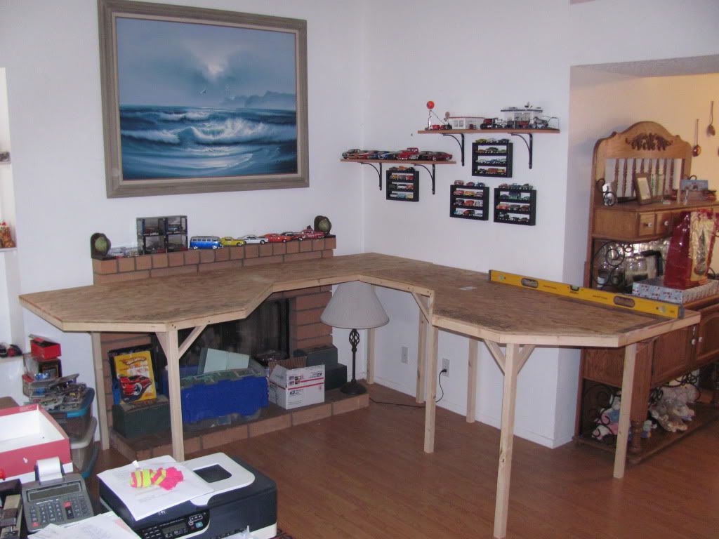

I am sure most here saw my "Box full of train stuff post" last week. Here is the little table I slapped together this weekend. I was able to lay some trial tracks and going to get some cork roadbed and start nailing down track soon. Wow a lot of work ahead! Too much fun. I am hooked big time dude! The HO Diorama accessories are endless. I was stuck on Ebay last night for hours looking at HO Train stuff. Also I am going to try and wire up all these track switches. Need too strip out some phone cord.
Did a little reading on track soldering / wiring. Do most of you solder your track pieces? Is it necessary? Or run a feeder line and tie-in every 3 feet or so? Anybody have a good link with some how to on soldering train track? I know how to solder and have the tools!
So far all the track switching works manually. Pretty cool considering I haven't done a Train in 25 years and that was a little oval at best! Comments or criticism welcomed!
Be sure and check this thread I will post progress pics here as our little world comes together!

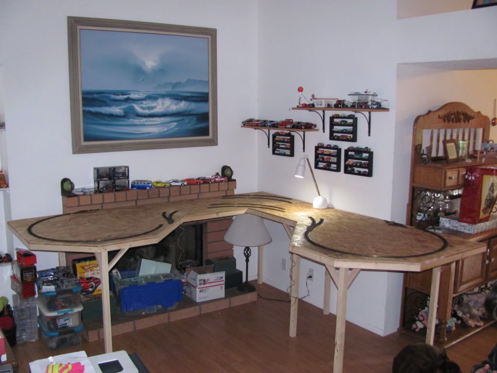

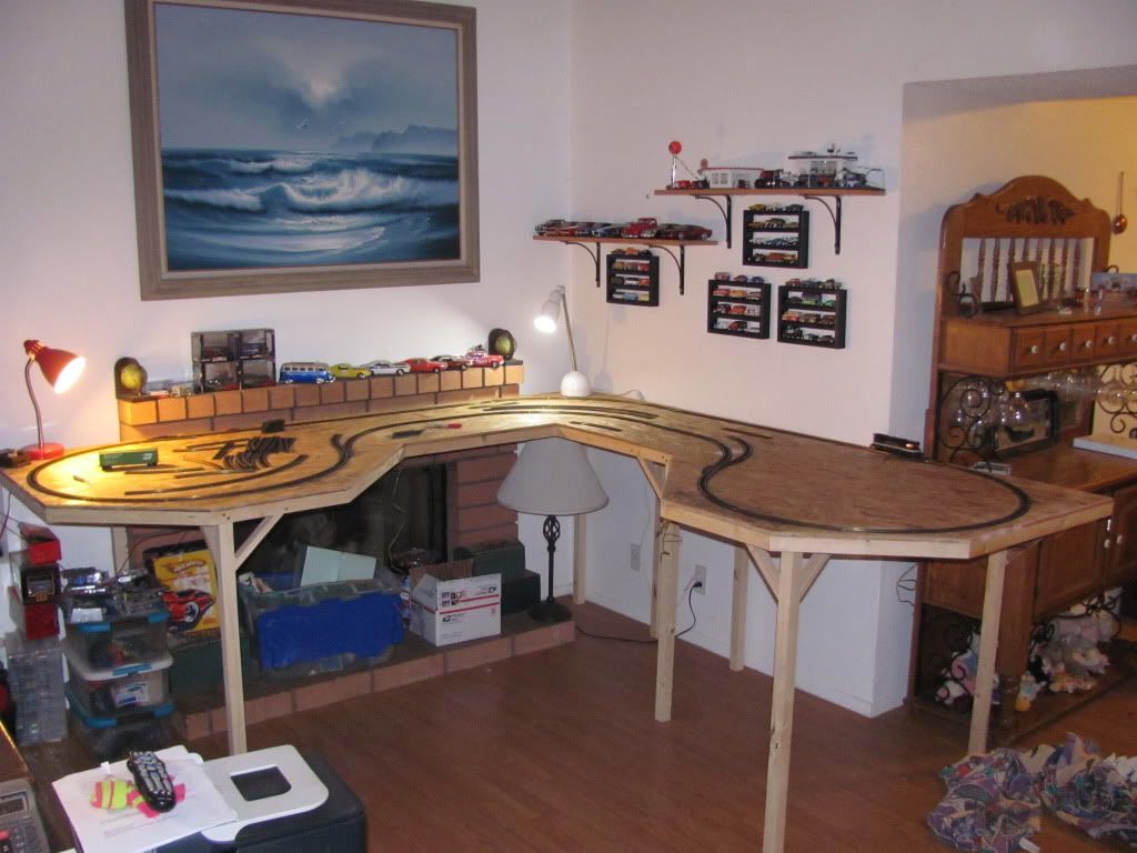

Here is a few update pics. I finally got all the roadbed glued down tonight now to nail it all down and start soldering track and running drop lines. This is cool! Like the biggest model I have ever built! All how I want to build it too! No real plan here!
