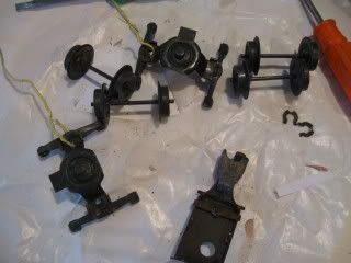

6017 caboose out of a box. I cleaned it up for use. First I took it apart the trucks were rusted.
The shell was washed with a soft brush and liquid soap and water.
I used a demel wire wheel on the trucks and cleaned up the frame .I used a q tip and paint thinner to clean the small areas on the trucks.
The trucks were broken down for cleaning and painting. Grey priner and flat black. The frame got primer and gloss black. The bottom piece holding the knuckle was just cleaned not painted . Sometimes the inside gets rusted and only then I paint it.
The finished product.

The wheels were very tight. Probably never taken off. I used a small screwdriver to pry the side up leaning on the wheel.I try to minimize the time I pry it. Those end piece are tough. The first axle is harder. The second tilts more and is easier.I left the bottom on and removed both axles from one side and all three pieces came off. If you have to remove the bottom by using the tabs I slightly open the tabs on the rear. Never move the tabs all the way use their tension and pry off. The front may bent just a little to get the clearance needed for removal. I went through 6 pieces of rolling stock today. It is easier to remove by taking both axles off. The newer plastic ones sometimes break.
