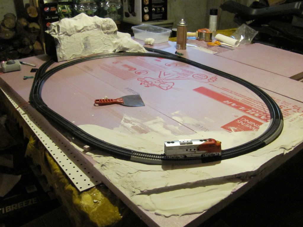

As you can see its a work in progress. We are very addicted to our new hobby, we have been working on it from the time we get home till the time we go to bed. Its not as big as I would have liked, but there is always time to add on later. The Sante Fe is hers, my locomotive is in the mail. Let me know what you think, and if you have any tips, as this is our first build.

what is underneath the foam? i would suggest a sturdier then pegboard foundation before you get to far. later if you will have to move it, without it the foam will flex to much and scenery will be flaking off. sandwich plywood for example or a frame. or is it sitting on a table?

Its sitting on the table for now( a pool table I got years ago and have only used for storage). If I decide for this not to be its final resting place than I will mount it on plywood.
You ought to decide before you build it.
And decide on how much space you can devote to it from the get go.
Theres never enough room for all the trains!:laugh:

A nice start, and kudos to your lady for doing it with you! I'd echo the comments about something rigid underneath before you go much further. Using the foam is good, but as they said, it will flex some when you lift it. No one here wants to tell you what to do or how to do it---that's a cardinal rule as well as good manners---but, we want you to succeed. The plasterwork adds weight and when you finally move it, the flexing of the foam might cause the plaster to crack. Even a sheet of 1/4" plywood beneath it would help you avoid that.
That aside, we're happy to have you both and hope to see more pics as your layout progresses!
