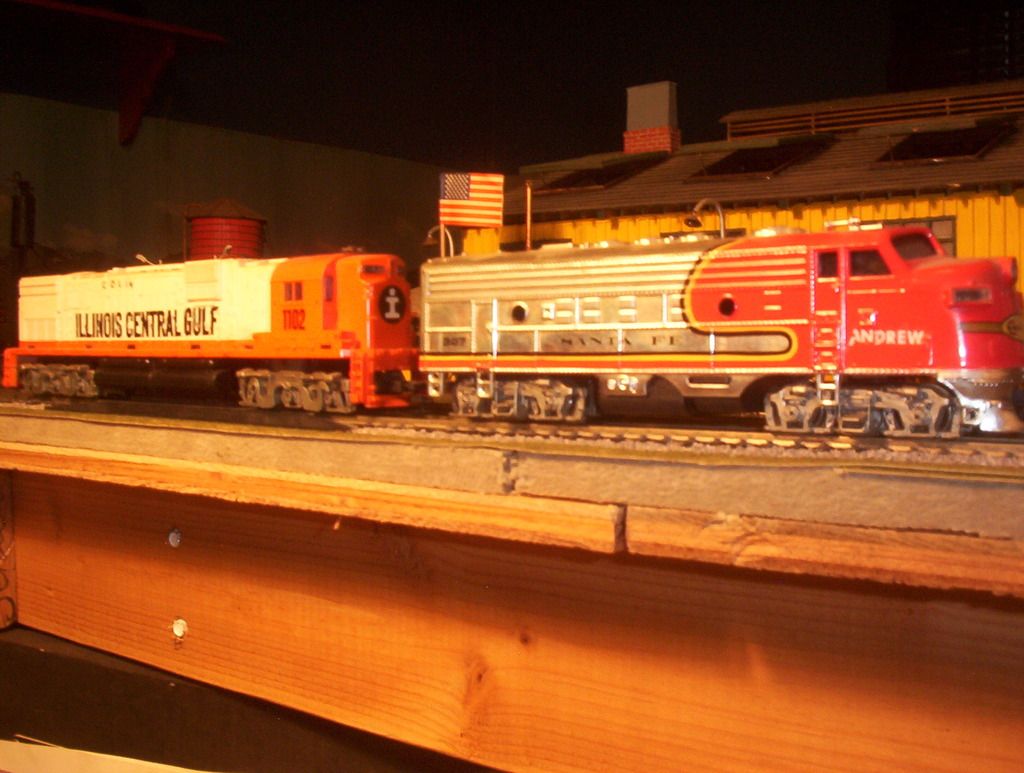

My Son's friend cleaned out his uncles attic & wanted to get rid of them, gave the kid 100, now that I look at it probably way too much, anyway it will give me many hours of tinkering, there's a few interesting pieces

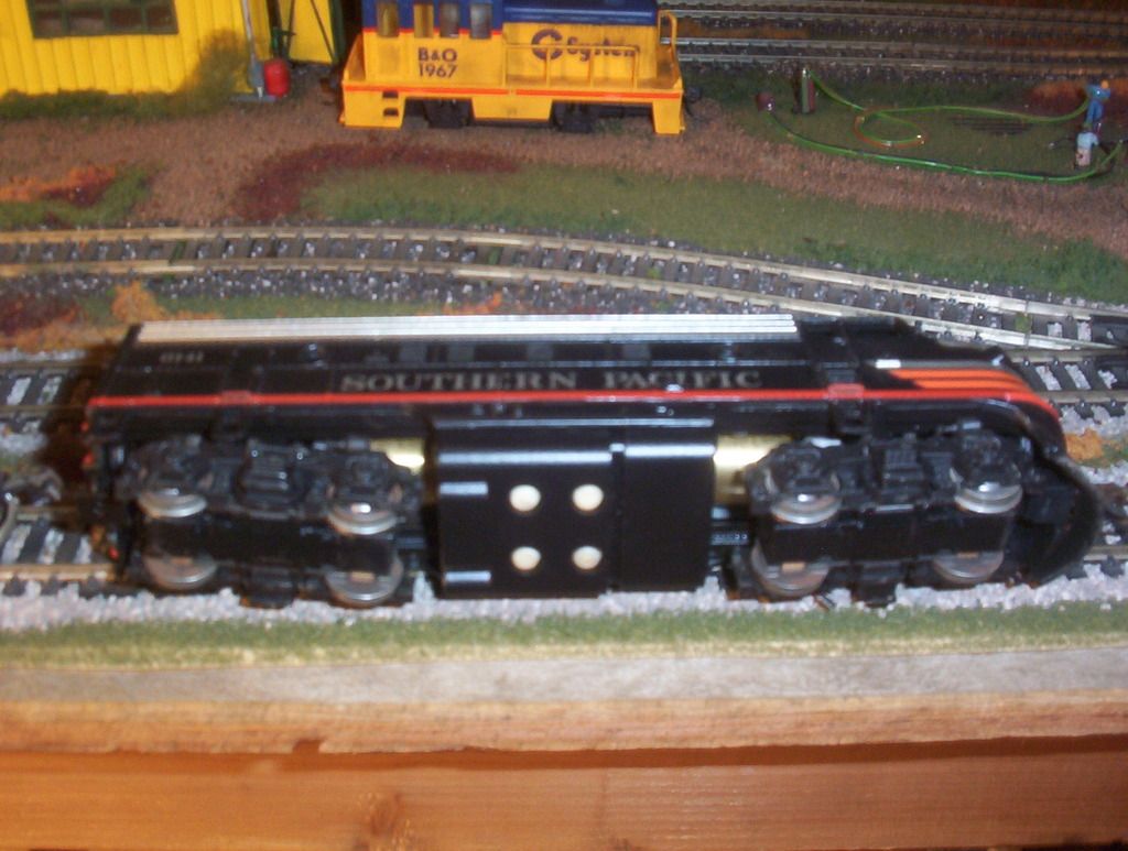

Athern?.........it runs
the santa fe runs Bachmann, the tyco is dead

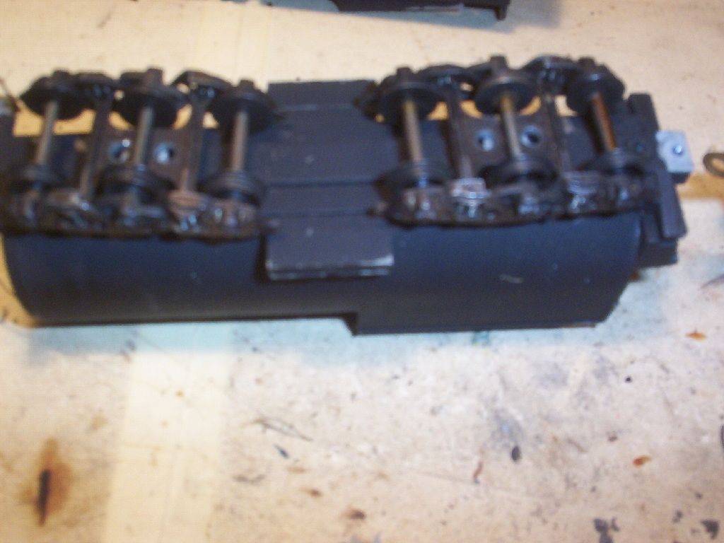

this just says made in japan, die cast & it's NJC I'd like to fix it up it's dead
this is a bowser again dead
The NJC looks like pretty intracit drive, don't think it's a real cheapie unit????????

Was pretty sure on the SP, that ran a little, gotta clean & lube & see what she's got left?
#6 ·
I haven't dug into anything yet, just put em on the track for a quick test, the 2 steamers & the tyco, NOTHING not even a light, the sp needed a little push as did the santa fe,

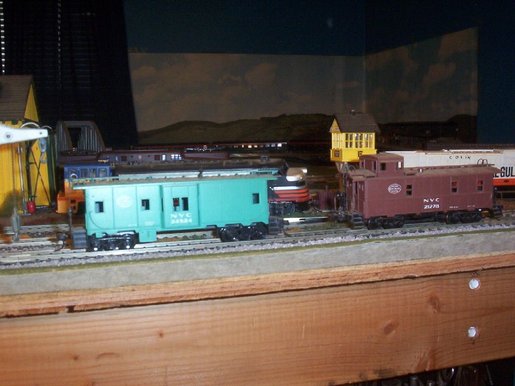

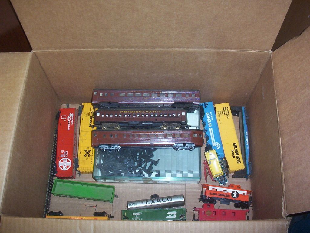

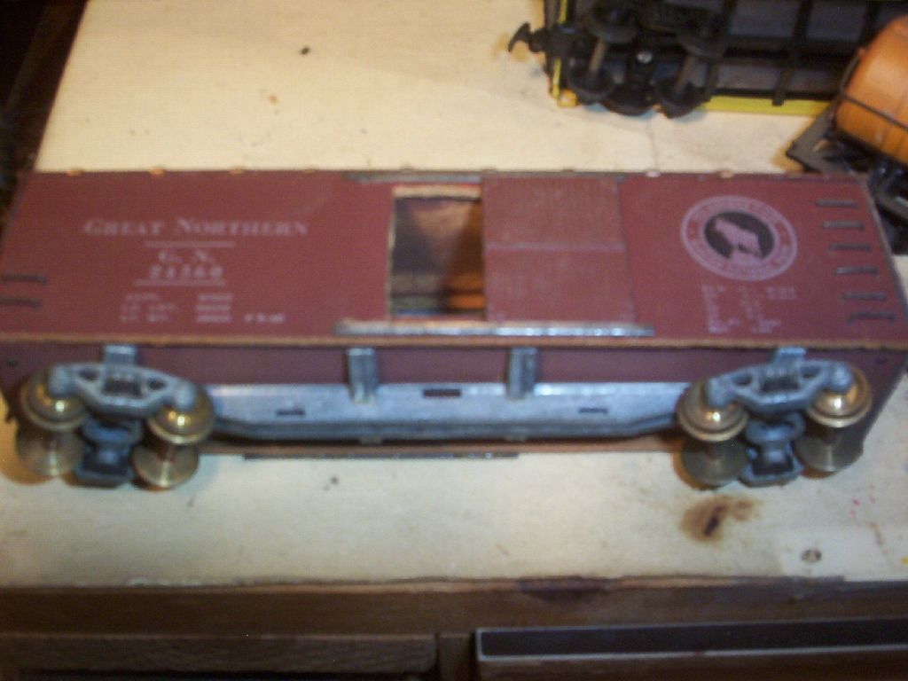

A few interesting cars........
this one is wood
these have tin? bodies, some on wood bases
mostly junk

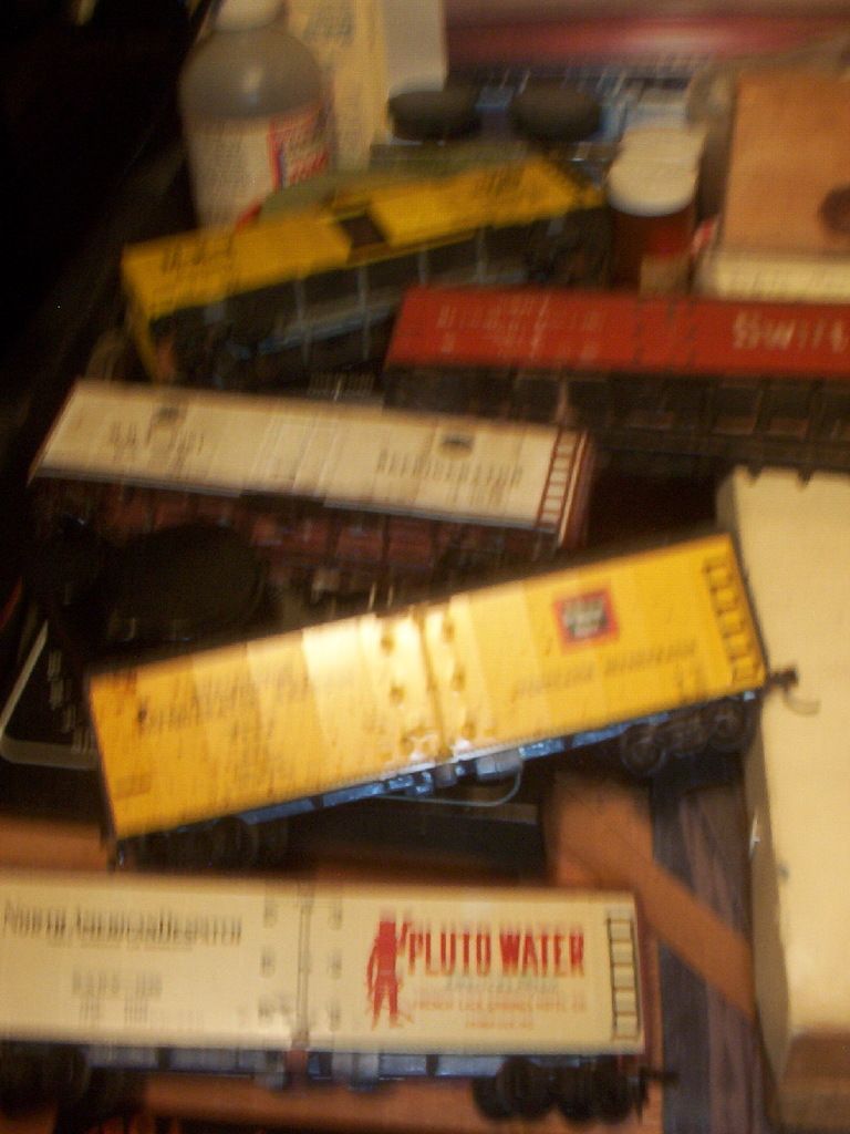

these I might put some work into
some new york stuff

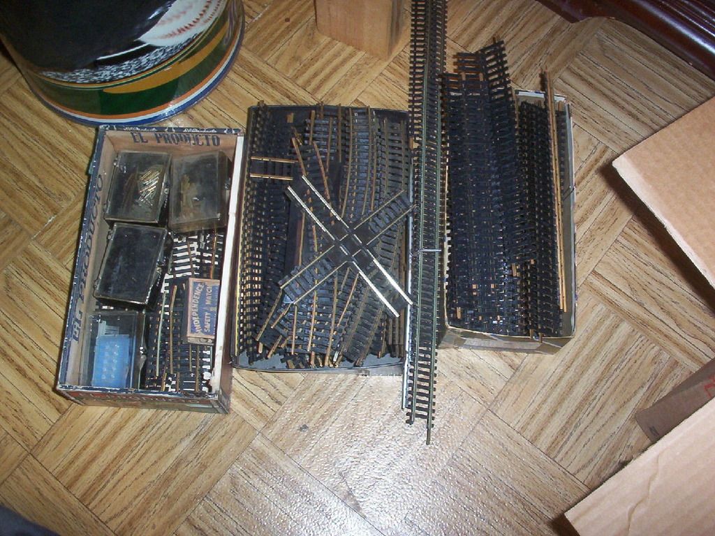

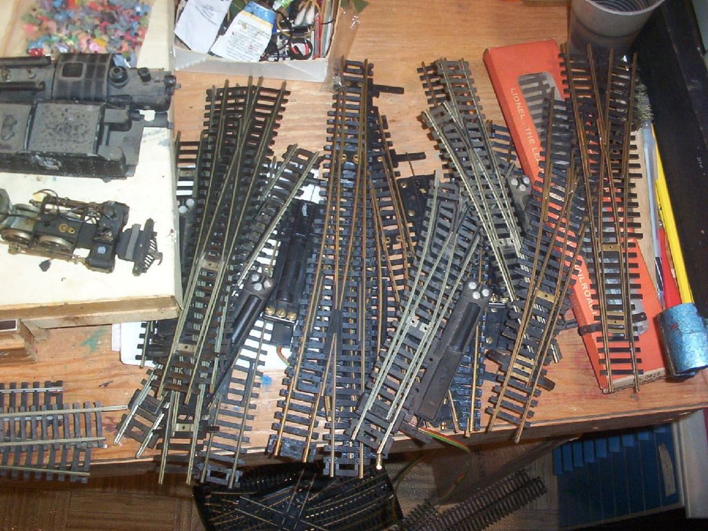

bunch a brass track & turnouts these may hit the payback post

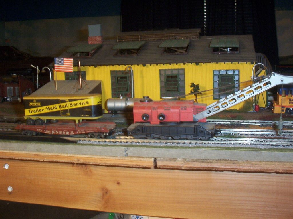

I think you did OK for a C note...the steam should clean up just fine for that alone...the Trailer Maid pig flat is a very nice catch and I believe hard to find. Mine heart is all aflutter over that European Big Hook....
#11 ·
The crane & the boom actually work , I have some work to do on the trucks, I'll try just a clean up first.
On Most of the cars the couplings are broken off ,everything is really dirty, so clean em up & get some couplings on & see how they roll.
The trailer maid caught my eye early, the flat car is pretty hefty, it looked old & well made so maybe a few gems in the lot.
& I got a beer car back in the collection, those were the first to be scarfed up when I sold some freight cars back then.

Putzed with the locos today, diesel side ok. Got the tyco running but not too smooth even after clean & lube.
The bachmann santa fe is not a bad loco, after clean & lube & a new light bulb she runs pretty good, it has all wheel pickup too.
The athern southern runs good, just cleaned up the outside, it wasn't as dirty as the others, will save the lube job for later.

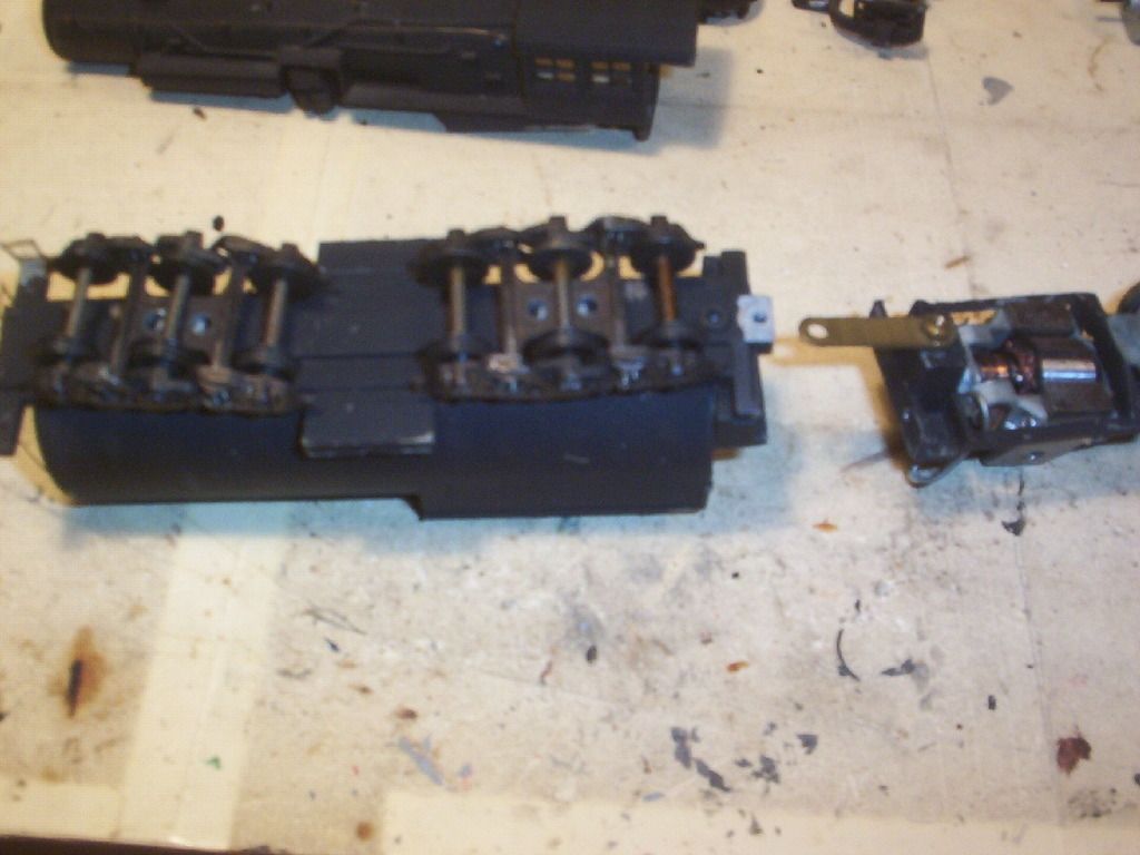

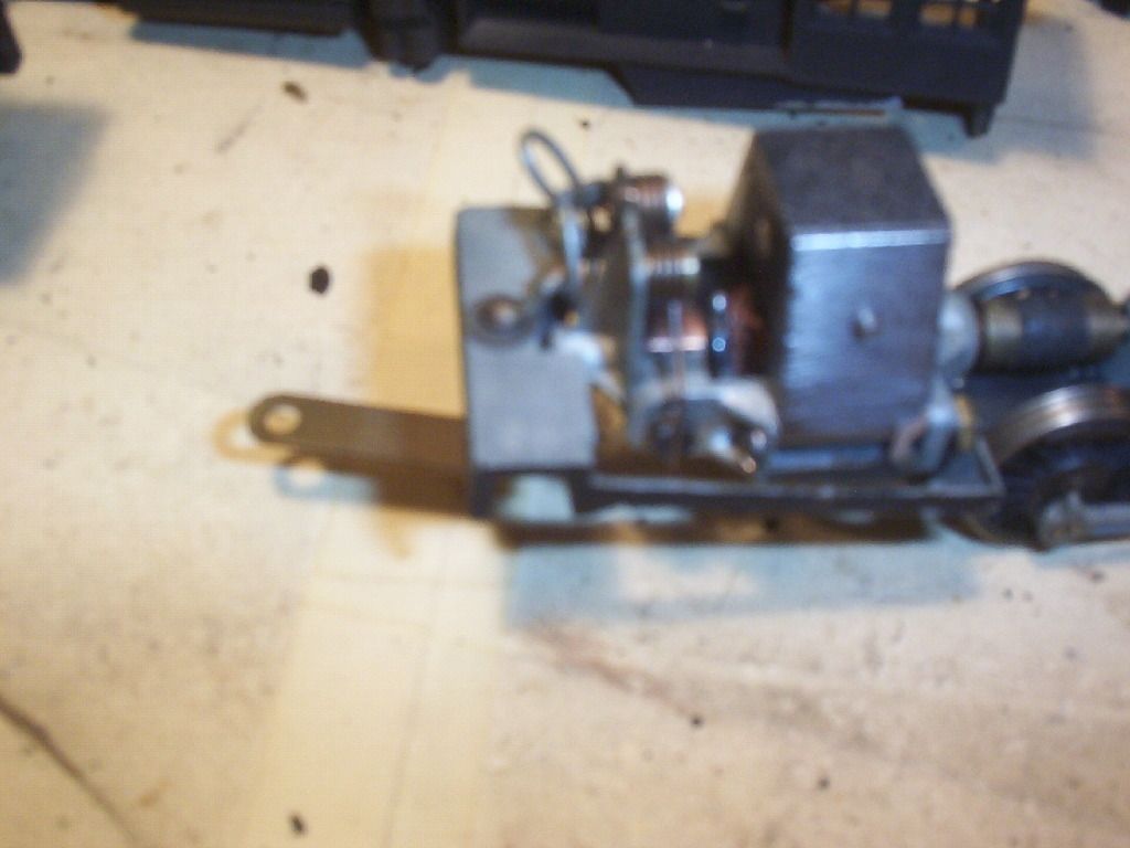

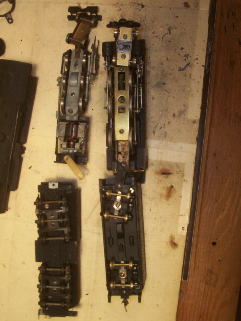

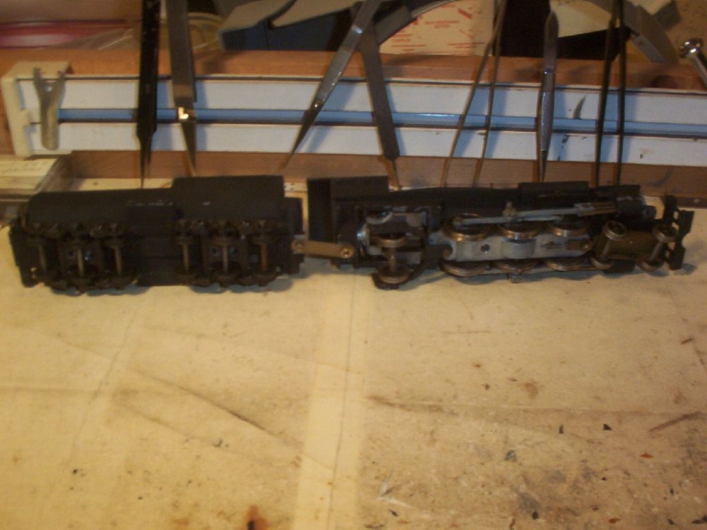

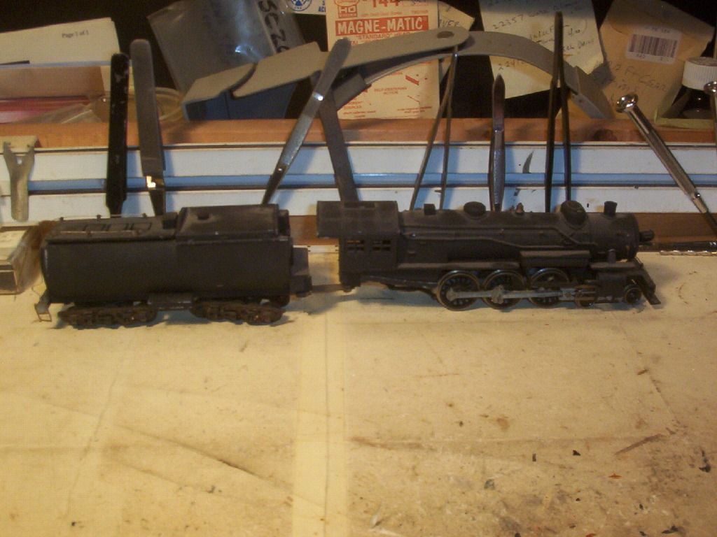

Not so lucky with the steam, the NJC can get the motor to run but have to bypass one of the brushes, cleaned the stator (if I have the right part name,where the brushes touch) & filed the brushes a tad, still no luck.
#19 ·
The bowser just a twitch out of the motor, haven't figured how to get to the brushes yet, but it also looks like it gets power for 1 lead from the tender, but I don't see how, no power pickups,wheels don't look isolated, here's a few pics & then one with my bowser next to it ???
#20 ·
Typical can motor replacements for steam engines. I can not read the lettering to know what kind of motor. Probably better than the open frame stock motors. If you clean the commutator and the brush surface then that is all that is required in the motor. Make sure the spring to put pressure on the brush is in place.
Next you need to be sure the rotor will turn freely. Then try to feed power to both sides of the motor. Sometimes difficult when still in the mount. It should fire at this point. If so the problem is further out. likely a broken connection or oxidation on the contact surface. Make sure they are clean and shinny. These usually can be brought back to a good operating condition. The poor conductivity and excess friction are usually at fault.

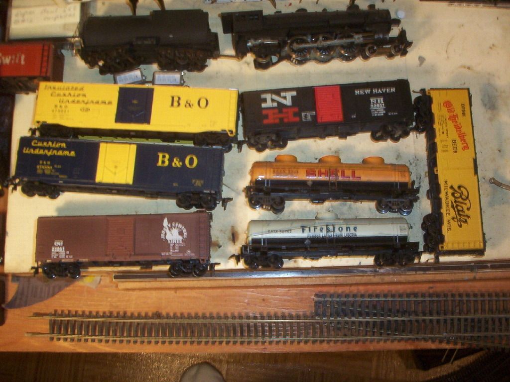

Looks to me like the 4 on the left side, Railbox, Santa Fe and the 2 gondolas,the Milwaukee and Conrail cars upper right and the ICG caboose of course. If you take a look they're probably marked either TYCO or Tiawan on the bottom. Not sure about the blue bulkhead flat.
