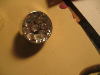

Another dollar store find. A LED flashlight that rotates 360 and goes up and down. A perfect replacement candidate.The lens can work with the old one with modifications. All for a buck.
Those lil flashlights are great for emergency lighting and doing repair work, too. The ability to position the light and have both hands free can't be underrated!

I have a soft spot for search lght cars. I thought iwould share another idea for a replacement light. The LED flashlight with nine LEDs. It could fit!!!!!! All you need is a three volt power supply. Somethig to think about.
Have you got the searchlight working with either of these ideas? How are you dealing with the drive washer?
I haven't gotten that far. It doesn't look good because of the wire connections to the lens. :eek:hwell: For now I just wanted to add it to the thread.
You could probably use it on the variety of the searchlight car that doesn't rotate, it has wires coming up to the light. :)

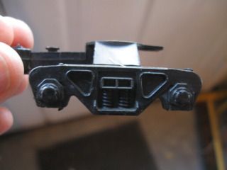

I have a 6822, and it has a plastic pickup roller assembly. The knuckle for the coupler isn't broken yet, but it looks very fragile. Looking at it and looking an an older metal coupler, it appears that the metal knuckle could be installed in the plastic coupler of the 6822. A rivet and spring would be needed. I think that the original knuckles for the 6822 cars are no longer available as they were a bad design.

Bruce do the trucks look likw this??
This is the thread on plastic trucks.
Mine two search light cars are in perfect condition but I almost want to swap to the hot water cap just for the look! lol great find.
Mike, One truck has a working coupler, the other a non-working coupler. The non-working coupler looks like the ones you posted. The working coupler looks like the one that Big Ed has on his searchlight car.

Here is the style. Mine have missing knuckles. I suggest e bay, a caboose lot.
Trucks are better if you plan ahead and find them at train shows. Lately I buy the pan with the complete coupler head with knuckle and add that to a postwar truck. Parts people also carry pans with a center contact roller too. They may sell trucks too.
