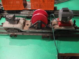

My service manual came up short on how to connect the searchlight to the reel. Any ideas?
The reel has a metal bar for spinning and each side is isolated. A contact comes up from the frame(inside) and touches the bar. I used an ohm meter and there is no connection from the bar. Two screws are on one side but the are isolated and the reel doesn't come apart.
12,499 Posts
Discussion Starter · #2 · (Edited)
OK I figured it out. Each bar on the ends are contacts. There is a hole for the wire to feed in and the spring tension holds the wire. It opens when you press it.
I am just about ready to assemble.
Cleaned and working. Keeping passengers in line.
