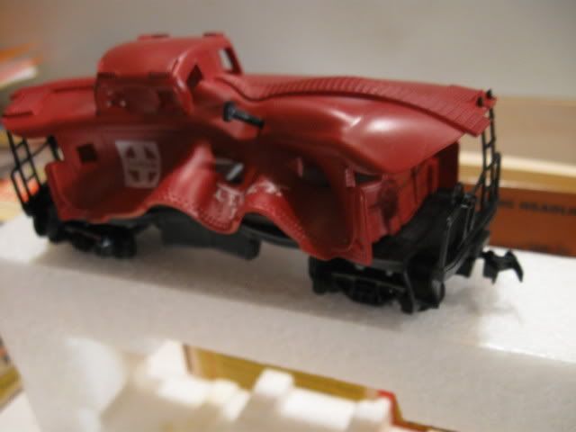

My HO BAby is Ready!!
Looks like that one got to close to a big transformer.
Or to close to the microwave
It's an original Tyco. I think it was in a Silver Streak set ,the chrome job years ago. That car gave me a set discount. Have no idea how it got melted in the set. Probably the first time out of the box.
Maybe I will experiment with a heat gun.
Even he fram got zapped a little. It actually is a nice styled caboose. I am so use to seeing the Lionel standard.
