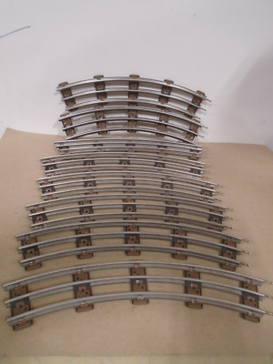

Its hard to find stuff as sometimes the sellers dont list it as being larger diameter. So, best to look at the pictures.
Not sure what radius it is, but its bigger then 27. Lol. Sometimes the amount of ties will give away the radius. I know 0 stuff, not that scolled in 027.
I do believe that is Marx O-27 in 34" radius. I have some. Five ties and 8 sections to a circle is unique to Marx wide radius. Decent price. But shipping inflation takes some of the fun out of it.
The Marx wide radius sections are in the SCARM database so it makes it easy to integrate into the design. Just select Marx O-27 sub-database and use section 802. Unfortunately, the Marx wide radius switches are not in the database. I have two of those switches as well (willing to part with them).

You should be able to find 42" curves in O27 profile. K-Line made 54" and even 72" in O27 but it's a bit harder to find. My entire layout is O27 tubular track and I only use 27" curves in the yard where smaller switchers roam. I could take a look and see if I have any extra curves to sell.
Marx also made 34" curves that are a slight improvement over 27", but they're older and most I've seen are in rusty condition.
